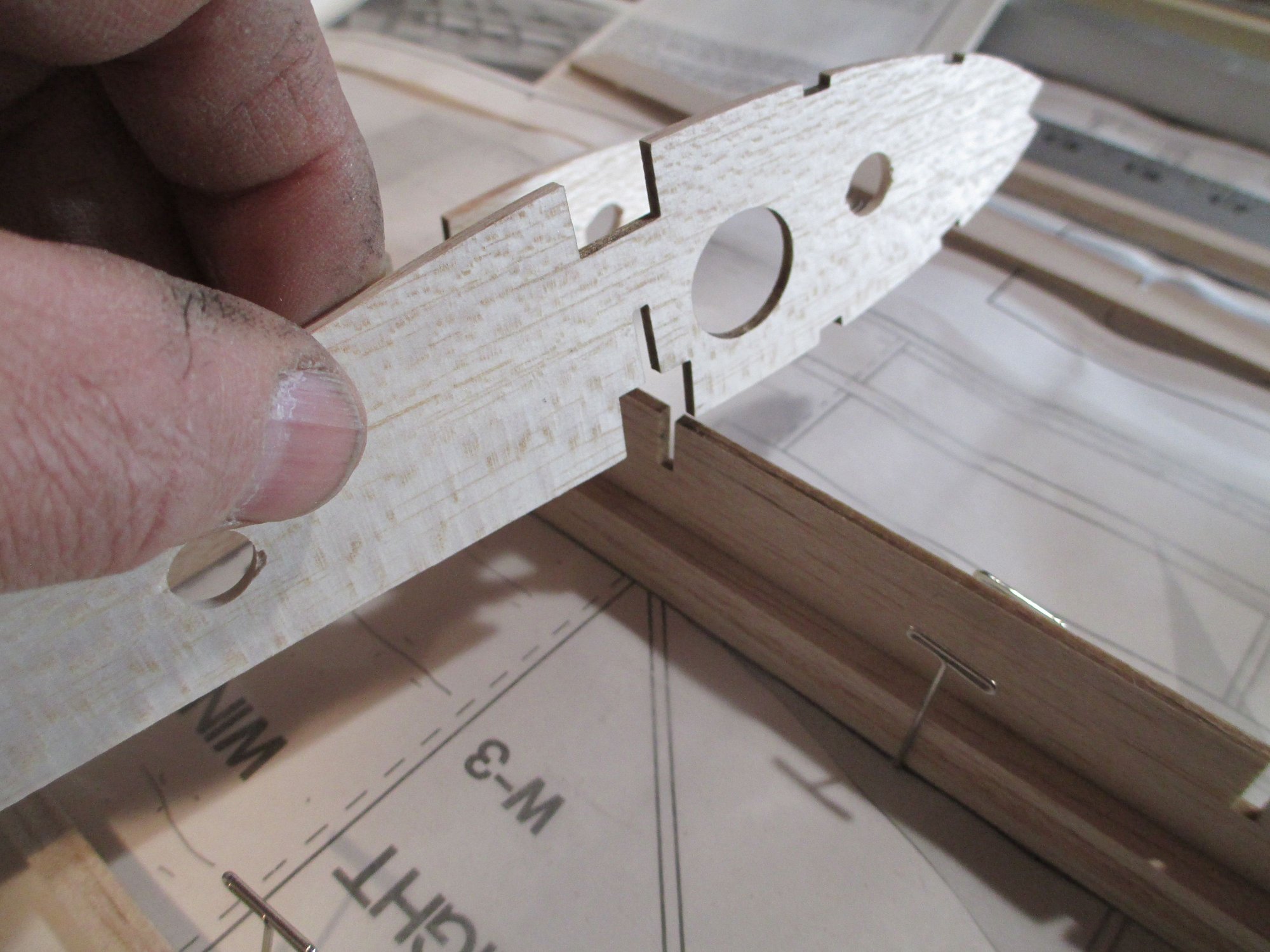

Great to see another one of your builds on the board, I'll definitely be following along.
I'm already curious to see what those notches in the ribs are at each of the spar locations. The plans appear to call out "Laser cut 3/32" balsa spar web" so it must allow the shear webs to key into the ribs? No answer necessary now, I'm sure all will be made clear...

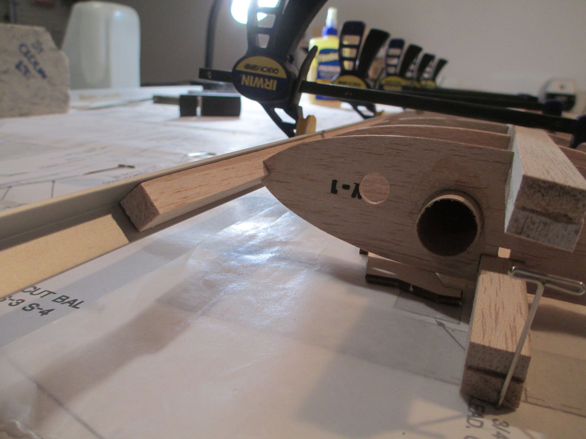

I started on the left wing panel. I am not installing the diagonal bracing shown on plans. I will be instead sheeting the top and bottom of the leading edge using 1/16" Balsa which will give it plenty of strength. The sheeting will terminate at the spar.
Notice that I am in no hurry to trim off the stock that overhangs the first rib. It will get removed once the entire wing is completed. I substituted the leading edge stock with 3/8" square stock. The additional thickness from the supplied wood is perfect for me to butt the 1/16" sheeting against it and be flush. The trailing edge stock was also replaced with thicker sheeting to accommodate 1/16" rib caps that I am adding which will terminate flush at the trailing edge.
I substituted the paper servo tube as called for in the plans for a much more stout rocket tube that fits perfectly in the rib openings. The rocket tubes will also give additional strength to the wing ribs...the weight penalty is negligible. You may have also noticed that I have added two lightening holes in each of the wing ribs, this along with the elimination of the diagonal bracing will help offset the additional weight of the sheeting that I will be adding.
Note:The first rib is glued into place at a slight angle giving the wing its dihedral when mated to the other wing panel. The stock dihedral for this plane is 2 degrees (per panel) which I have re-adjusted to 1 degree.
Rocket tubes come in a variety of different diameters.

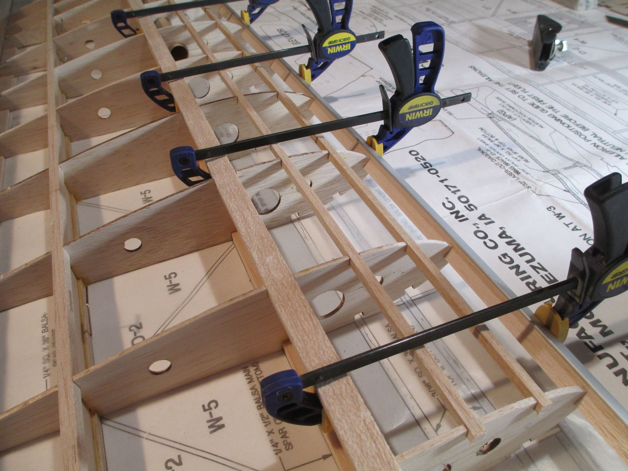

You can see in this photo the outer wing bay has been eliminated as well as all the diagonal bracing.
The left wing is ready to be partially sheeted using 1/16" stock.
I chose to plank the first four bays leaving gaps between the planking to help minimize weight.
I could have just cut four ribs larger and swapped them out for what was supplied eliminating the planking...your call.
The trailing edge came out straight and true.. Inboard #1 rib which is set at 1 degree for the wing's dihedral, still needs to be sanded flush. It's also easy to see here how the TE sheet stock (1/8") is thicker than the planking which is 3/32". The difference will allow the final sheeting to be near flush with the TE.

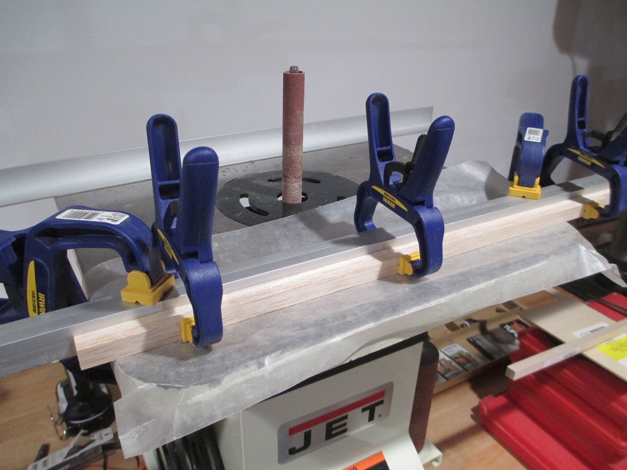

The process starts by epoxying two 1/4"x 1/2" balsa sticks together. Once cured, it will become one of two wing spars.
The key to getting a nice and straight spar is to make sure that they are clamped to something that is straight and flat. (In this case I used aluminum square stock and the cast iron base of my disc sander.)
Here's a builders tip: Clamp everything dry first, that way you won't have any surprises once you apply the epoxy. Maybe the set-up that you thought would work won't, leaving you to quickly come up with a better solution rushing against the epoxy curing time. Better to find out dry first!

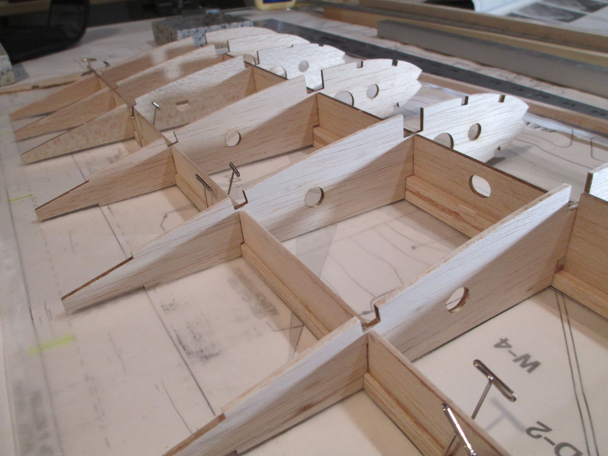

This way of building is conducive to using CA. Since I don't use CA this type of construction is a real PITA...
All the pieces laid out.
With the bottom main spar pinned into position, the one piece shear web is placed on top. (This is the first time I've seen the grain in the shear webbing running in that direction. I always orientate the grain vertically for strength.)
All of the ribs simply interlock together. A very easy way to construct a wing if it's your first build. (I apologize how my hands look, working on cars for a living make them look that way, they really are clean...)
Double bonus building tip for tonight! Tip #1- The 1/4" x 1/4" square stock shown is the bottom rear wing spar (no that's not the tip). Notice how I've pushed the spar tight against the aluminum square tubing. This is a good way to ensure that the spar is pinned straight over the plans. Don't trust the lines on your plans to be straight and true, especially if your plans don't lay flat as is most of the case with folded plans.
Tip #2-You may think that your balsa square stock is dimensionally equal. It probably isn't, so before you pin your stock down find which side fits tighter in the notch of the rib. You will see and feel the difference.
