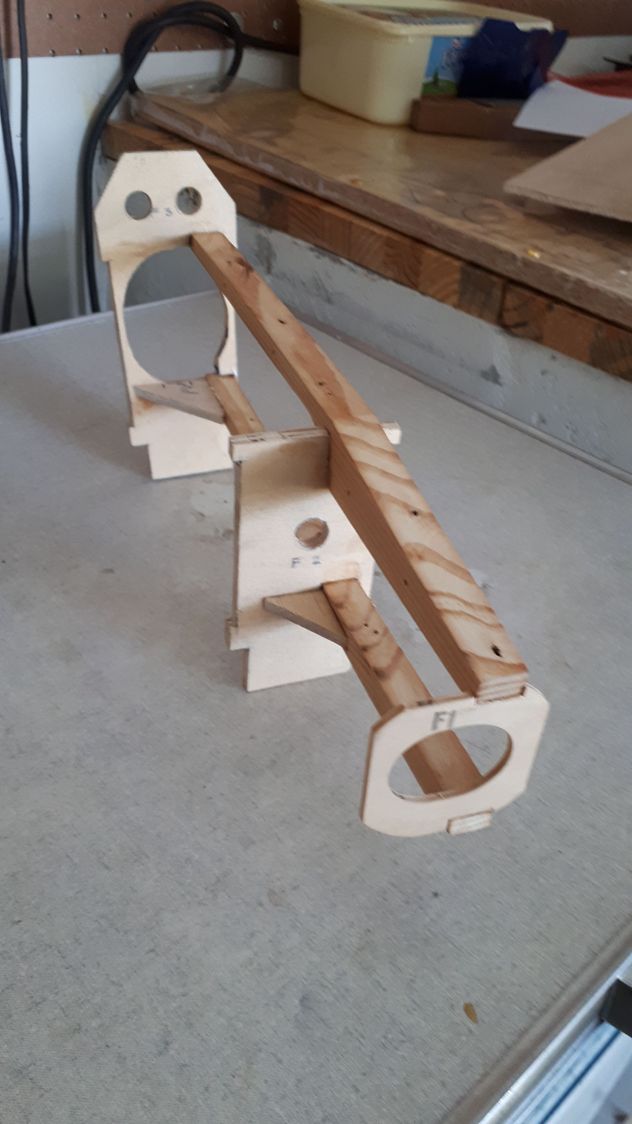

Good day all
So im building a 70s curare kit (see pix) I had to build the nose from scratch since some parts went missing during a move.
Some advice please?
- Paint or cover? I would prefer paint but it might be heavier. What paint or cover would you recommend?
- What make of retracts would you recommend?
Thanks in advance!

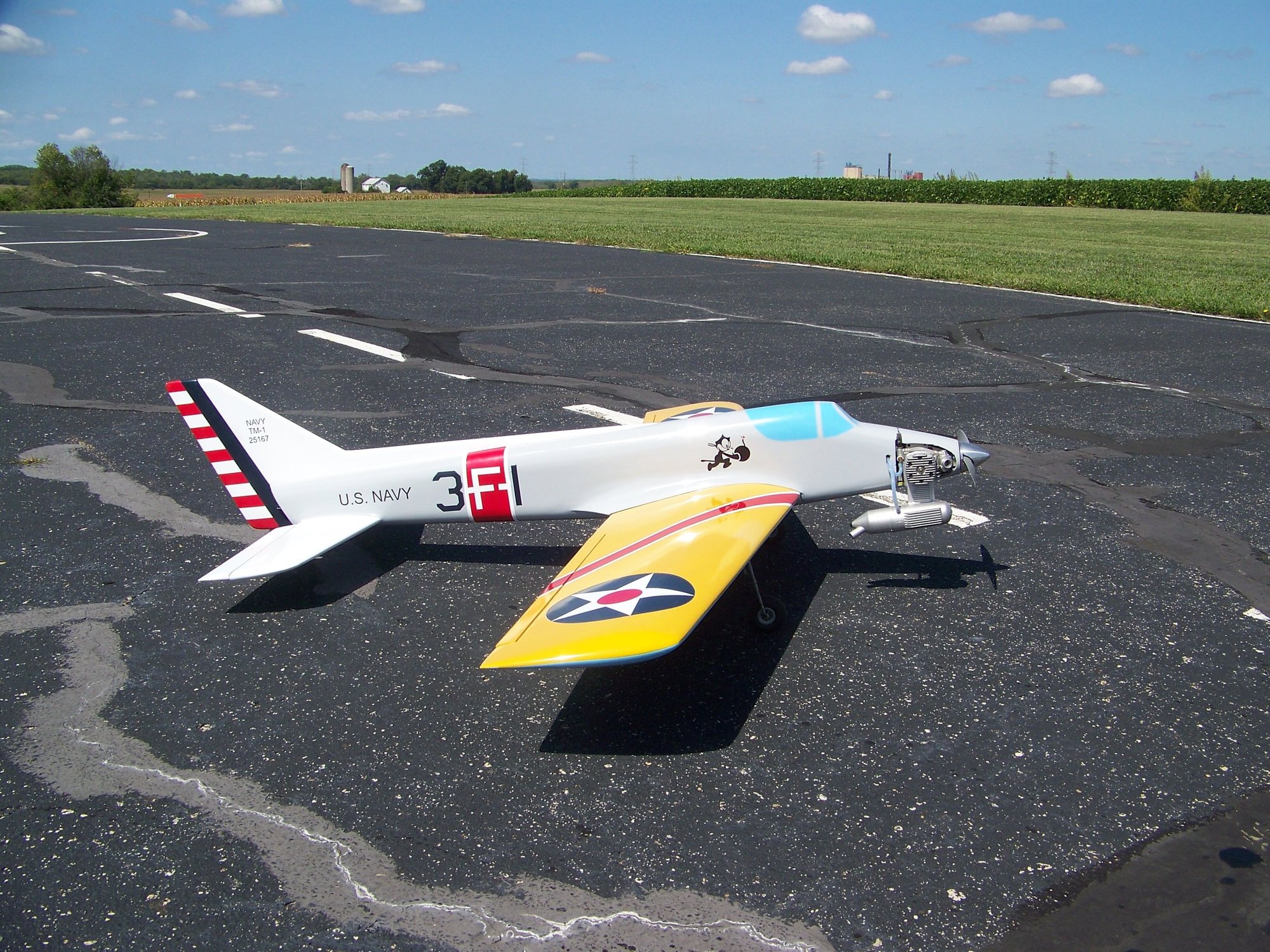

If I expect a model to last more than few months I have been glassing and painting them. My film covered models all seem to start having wrinkles and the seams come unglued. With generous use of sandpaper and elbow grease I can get a glass finish at the same weight as Monocoat. Both the Dirty Birdie and Troublemaker in the photos have built up and sheeted wings. DB is 7#11oz, TM is 7# 3 oz.

Both models were done with .75 oz fiberglass cloth, epoxy finishing resin, polyurethane primer, and Klass Kote epoxy paint.

+1 on R8893's advice. It may be more work up front but i find that a glass finish holds up well in the long term.
