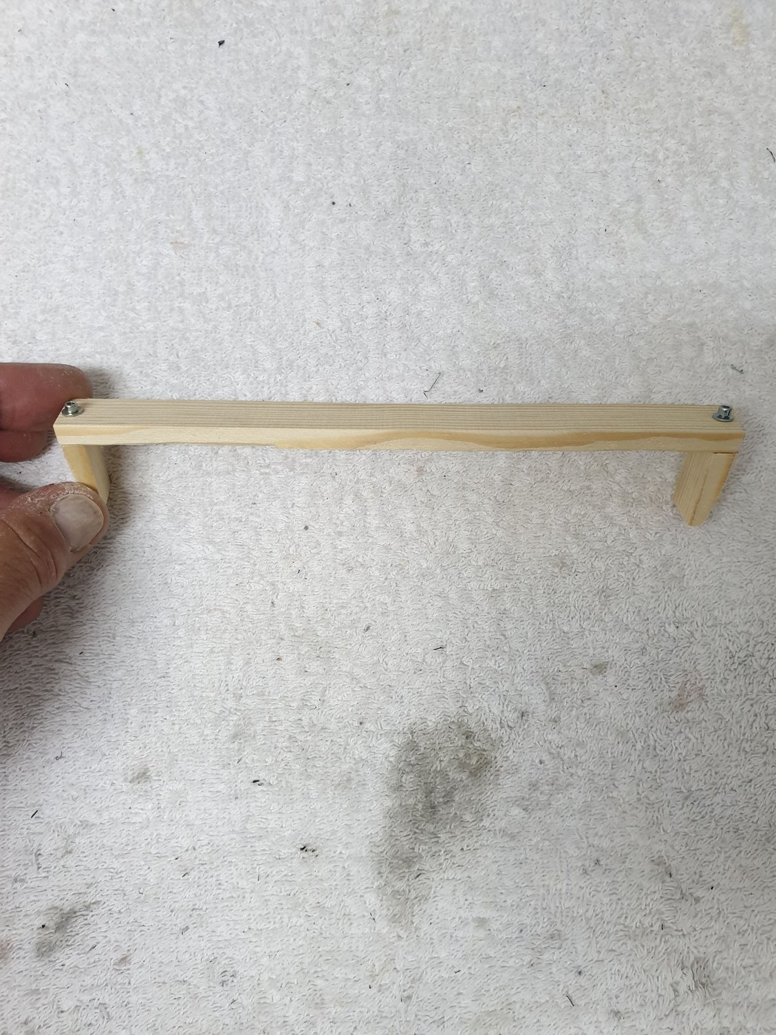

#53
IAF-Zukit-Fouga Magister (RCJC)
One of two removable crossmembers. Each has two supports glued to the fuselage.
Each crossmember has 2 screws securing it to place. One in each side.

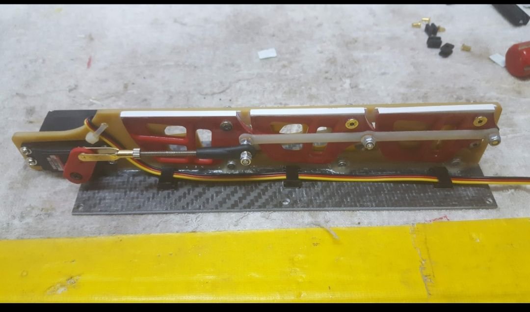

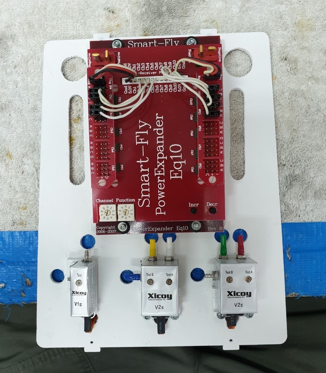

#55
Next step - the equipment/systems trays. I spent some time playing and designing the layout for the equipment and systems based on what I'm using. Even though they are covered with the cockpits I wanted all to be nicely mounted and routed. All equipment was installed, verified for proper operation and then removed to paint the trays before final assembly.
I spent hours to get the air system working correctly with the Xicoy sequencer/failsafe. I also used the info here in RCU and got great service from Xicoy support but couldn't get it to work with the time delay I wanted for the gear/doors. Eventually it results with a combination of Xicoy as failsafe and Jetronics for sequencer.
After all it works as I needed it.

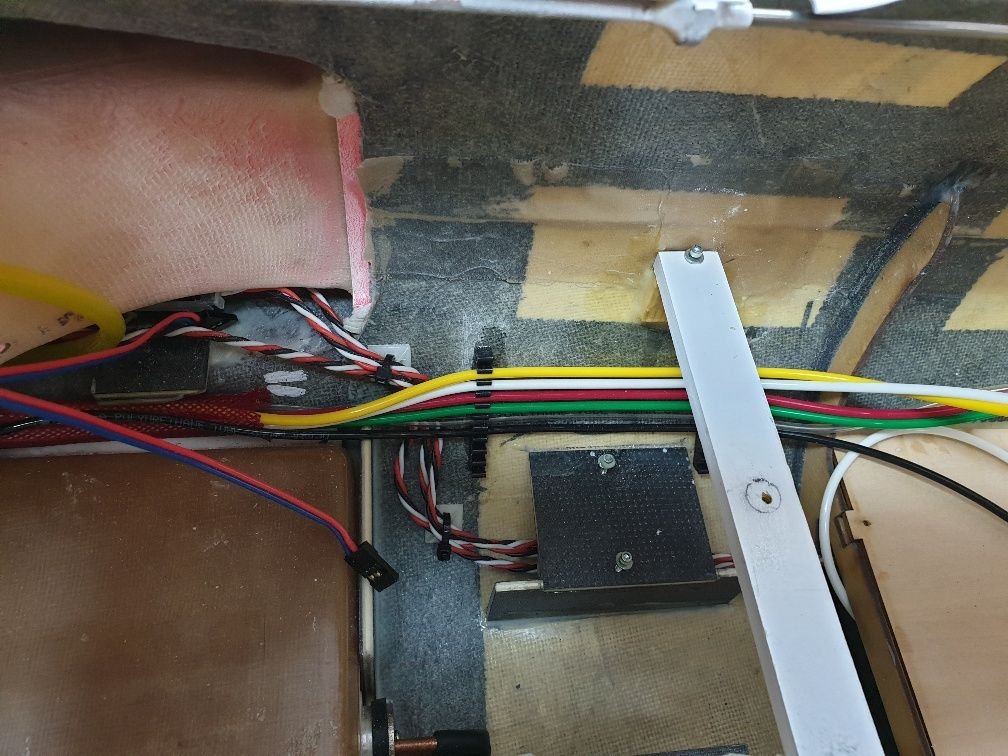

#56
Center crossmember.
Rear equipment tray final adjustments.
Almost ready. Final configuration involved with changing the retracts air lines and other minor things. As my wife frequently tells me "you are the only one how see this things..."
I just sleep better knowing they are like this 😄
In this picture you can also see the use of carbon to reinforce the fuselage in the formers areas.
The entire structure is of high quality.

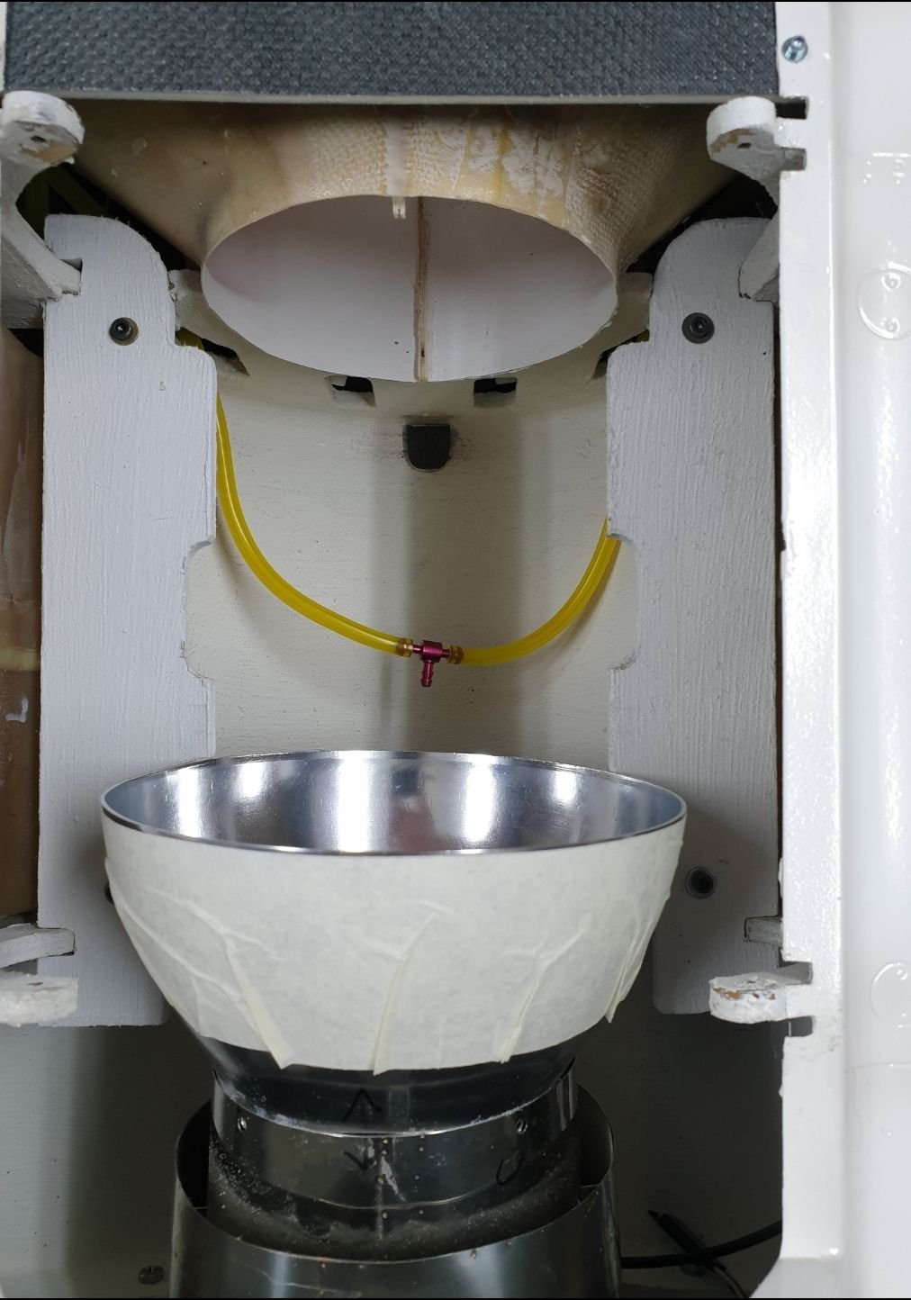

Turbine and tail pipe/exhaust installation was relativly easy. Had to move the turbine forward as posible to get the correct C.G without ballasts. At the same time had to move the double tail pipe rear as possible for two reasons:
1. Ensure proper distance from turbine outlet to tail pipe.
2. Get the turbine in/out without having to separate the fuselage. Note that because it is double tail pipe it cannot be moved rearward.
I ended trimming some of the double inlet duct in two places for the turbine starter.
Engine bay final mesurments. The engine rails had to be shaped to acomodate the engine. The fuel vent lines waiting to be instald.
The starter is looking forward through the inlet duct just to be engaged...
Almost there...
Double tail pipe-"Y" shape. This is why it can't be moved rearward too much. Note the 3 air tanks. The left one must be removed if the tail pipe has to go out.

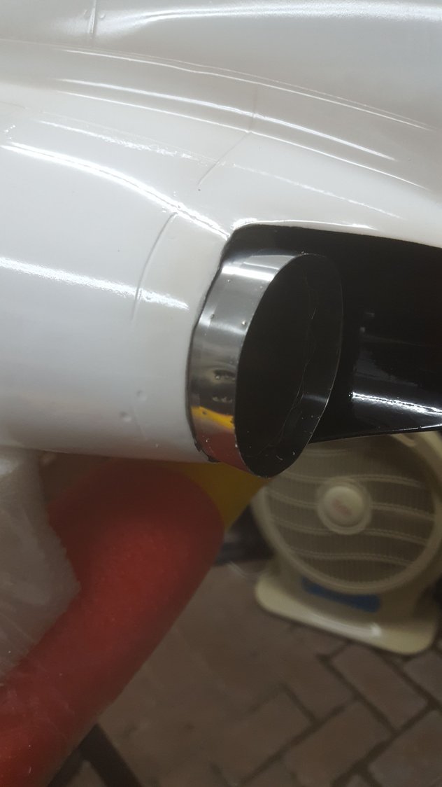

#66
The tail pipe is about 20 mm out of the fuselage. This will not generate too much heat to harm the skin. The kit comes with two thin metal plates to be added in this location. I was in doubt what to do here since the full scale plane don't have such tail pipe sticking out like this. However I couldn't leave them too much inside(frontwise).Eventually I didn't used the metal plates and the area can handle the temp.

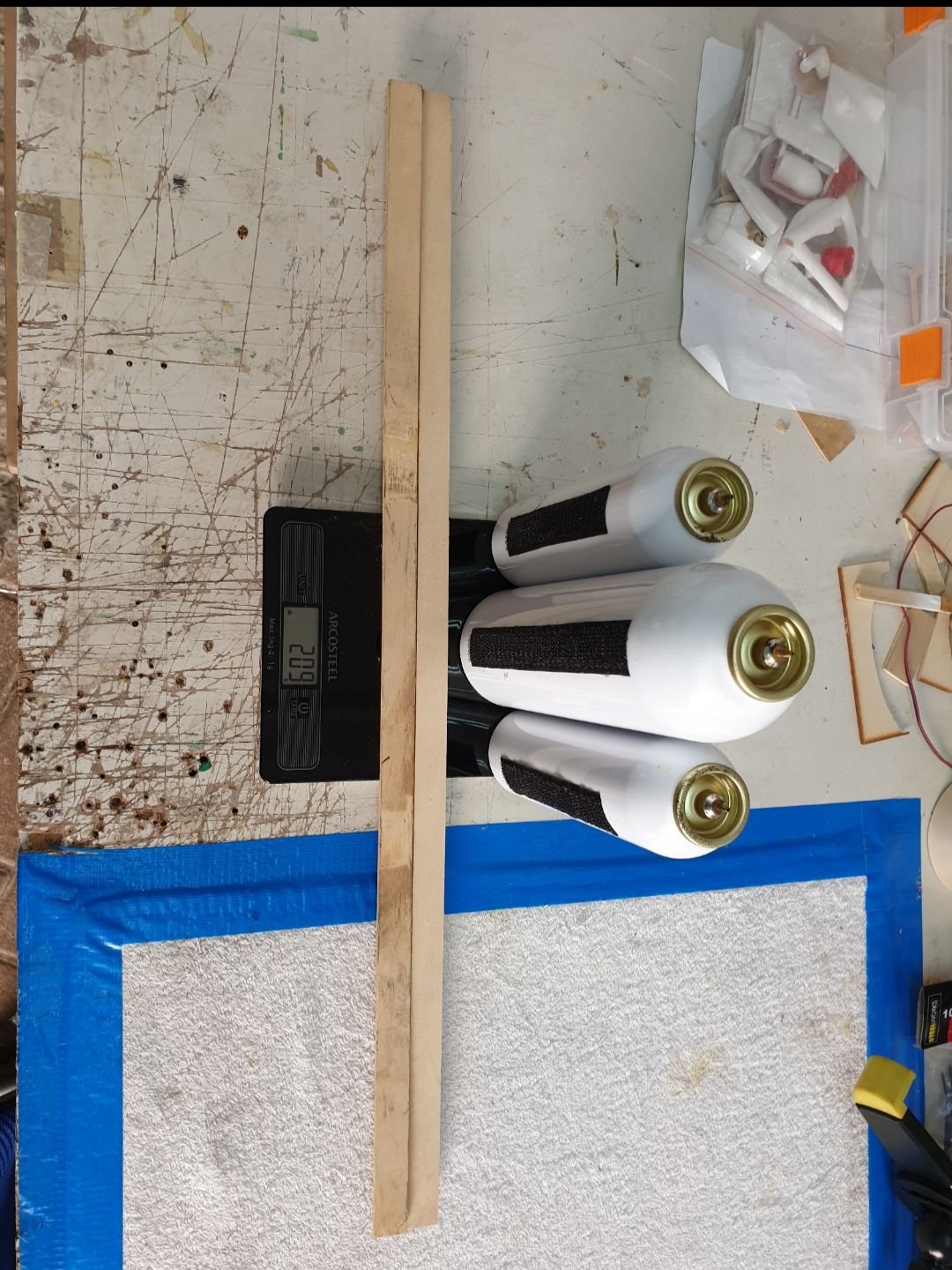

Air tanks. The kit arrives with one big tank and 2 smaller tanks. To have maximum retraction cycles I decided to use the big with one of the smaller tanks for retracts+doors and the third tank for brakes.
The tanks are located in such way that one of the smaller tanks must be taken out so the tail pipe can be removed. This wad done by making a removable wooded bracket for one of the smaller tanks. All have been heat protected in relevant areas.
Each tank is secured with but not only valcro strips.
All tanks and wood for support are about 209 gr.
The air tanks arrangement . Each one is secured with valcro and wooden bracket. Note the big and one of the smaller tanks have a removable brackets. The big tank is almost in center to give space for one of the hot air vents.

Avi,
Mine hasn’t flown yet, I was having trouble with a few things last year, and had changed my mind on the turbine so that brought me to the end of the season. I had originally installed a Jet Central rabbit 100nm and it had a hard time taxing in the grass so I decided I wanted more power. I am also having a strange problem with the gear. When it’s sitting on it’s wheels it is very hard to move. It does’t want to move freely, it took full power just to get it to move. However when it’s suspended the wheels move freely. I have taken everything apart several times, lubricated/adjusted/etc, and even removed the brakes to try and get things to move freely.
Also after several measures to mitigate heat soaking (no vents like yours, that’s one of the mods I will incorporate) the brake lines have come off more then once from the tanks. I had used the stock air lines, but I think I will take them out and replace them with festo, I think that will help. Also one of my air cylinders for the main gear doors is leaking badly so I will need to deal with that.
When I install the turbine again I will move it more forward, I was afraid the fist time I installed it to cut out material from the intake ducking. Now that Ive seen yours I will do the same, which will give me proper spacing to the thrust tube and take out some weight out of the nose.
Lastly I never liked the pull pull cable nose wheel steering, and after seeing yours I think I will do the same modification to mine to eliminate the cable system.
So not quite a total rebuild, but several changes need to be done to make me more happy with the plane. As soon as I am done my current build I will get the Fouga on the bench and start the refit.
