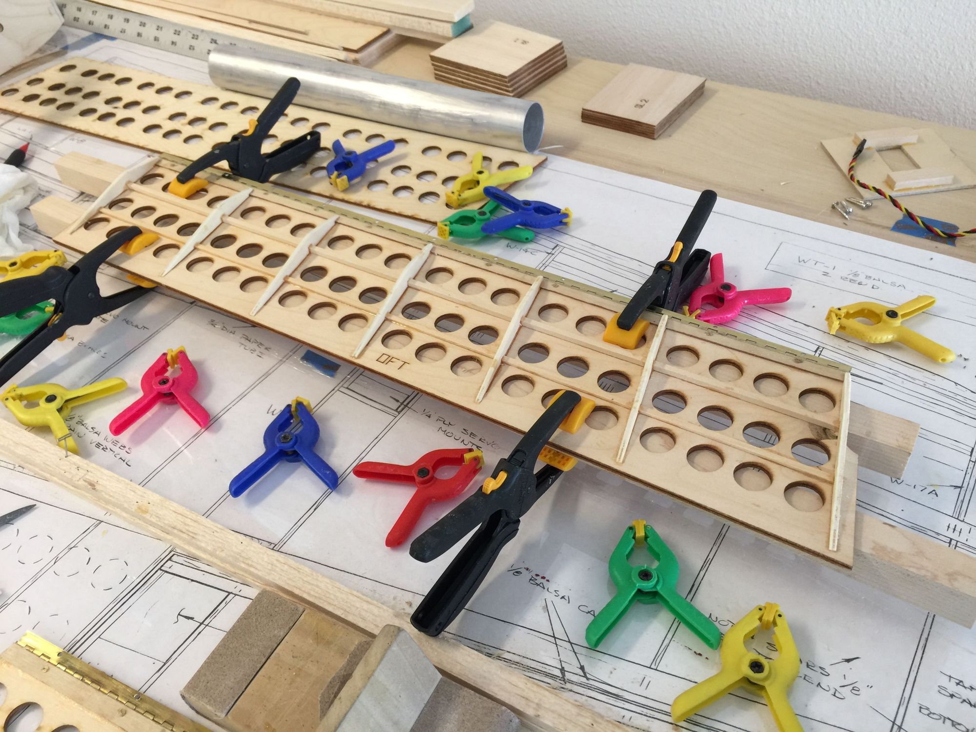

Getting the flaps and brakes prep'd for the wings. Used the same approach that was used for the center flap. The Nelson hinge was scuffed and epoxied with a layer of 1/32" ply on top.
