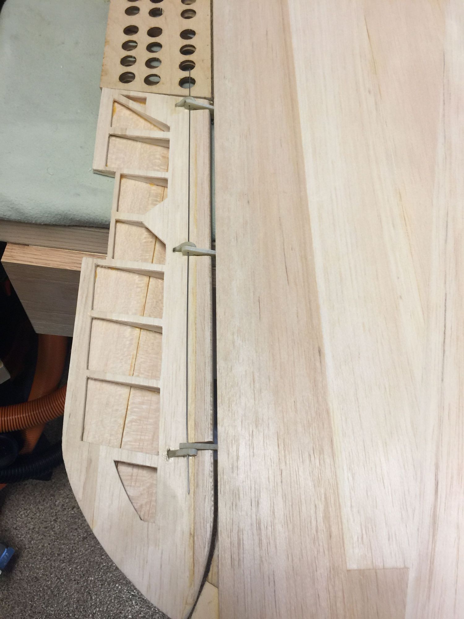

BatteryBob September 30, 2018
Once I was happy with the alignment of surfaces between the wing and the aileron, I began setting the G10 parts in epoxy. I still have a lot of shaping to do on the LE of the aileron. I also will need to at a cap to the TE of the wing and shape the wing TE to get the right coverage on the top.
