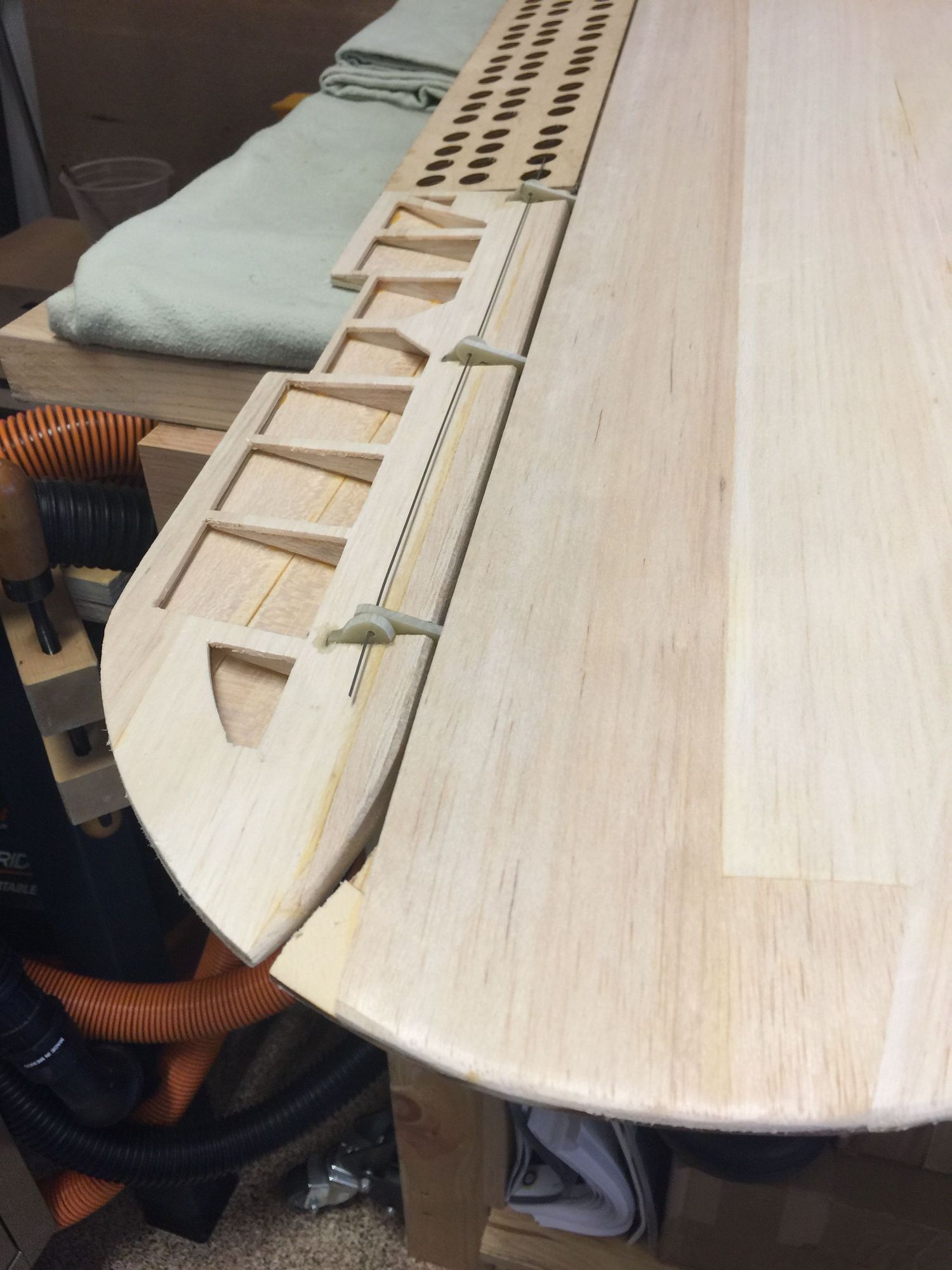

BatteryBob September 30, 2018
Adding some views of the bottom to show the hinge points. Arms were lined up using a wire to first line up the right height for the points on the aileron and then later to located the holes on the arms from the wing TE.
