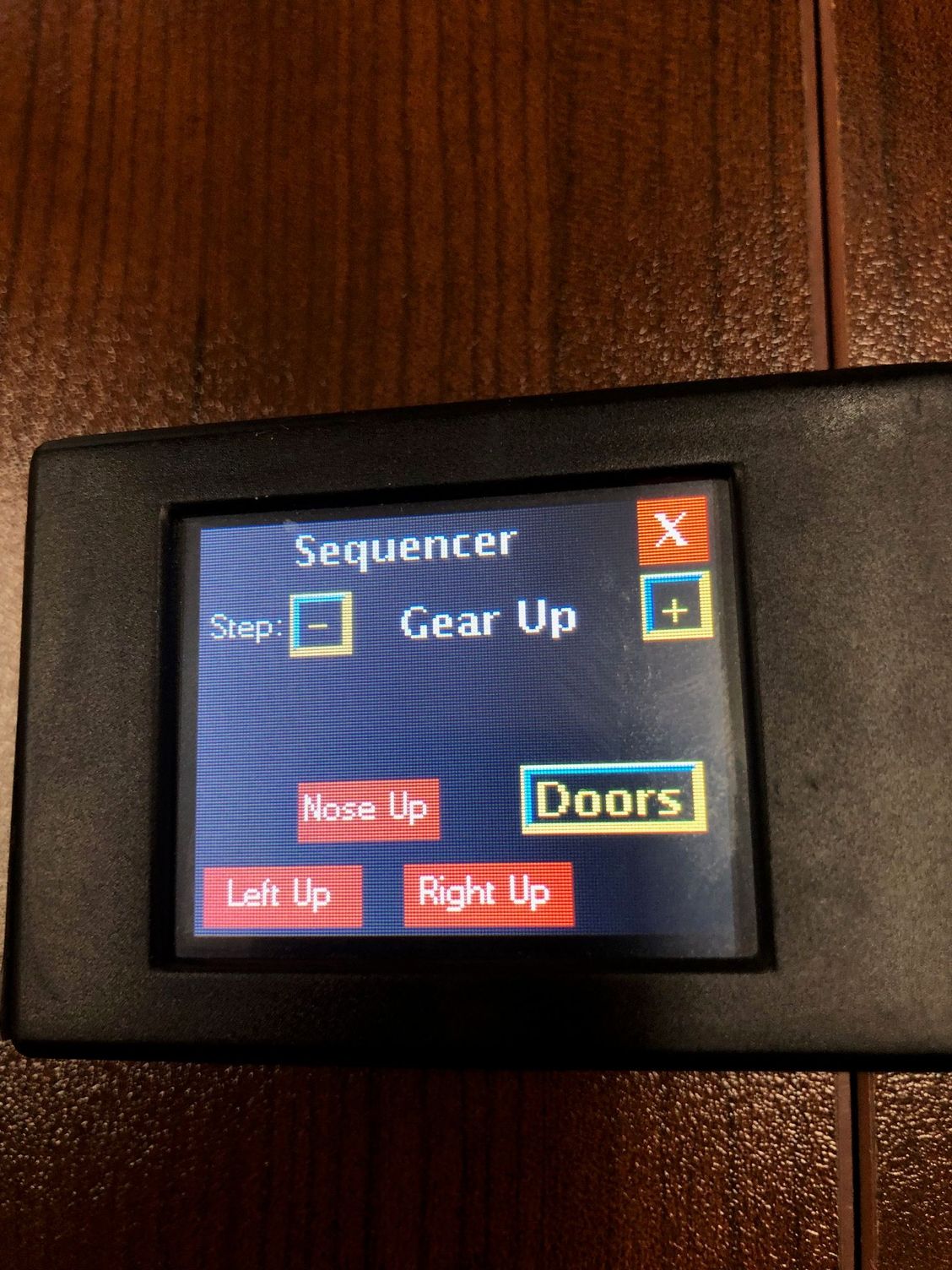

This is the starting point, click on the '-' button until you see \"Gear Up". Then check that all three gear are up (Red) as indicated by the three red squares. If the any of the three squares are Green click on it to make it Red. If you click on the Doors button you will see the following...
