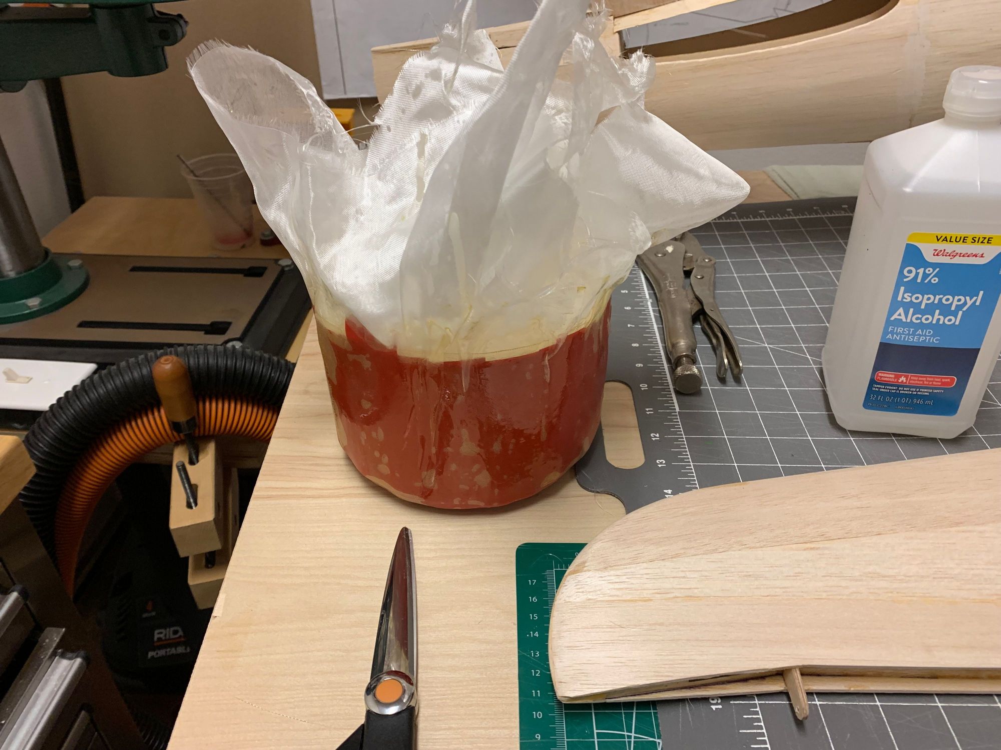

I used a 3/4 oz layer first, followed by 2 oz, 5 (two pieces - top and side), and one more 3/4 oz layer. I'm not an expert at this, it's just what I'm used to using.
