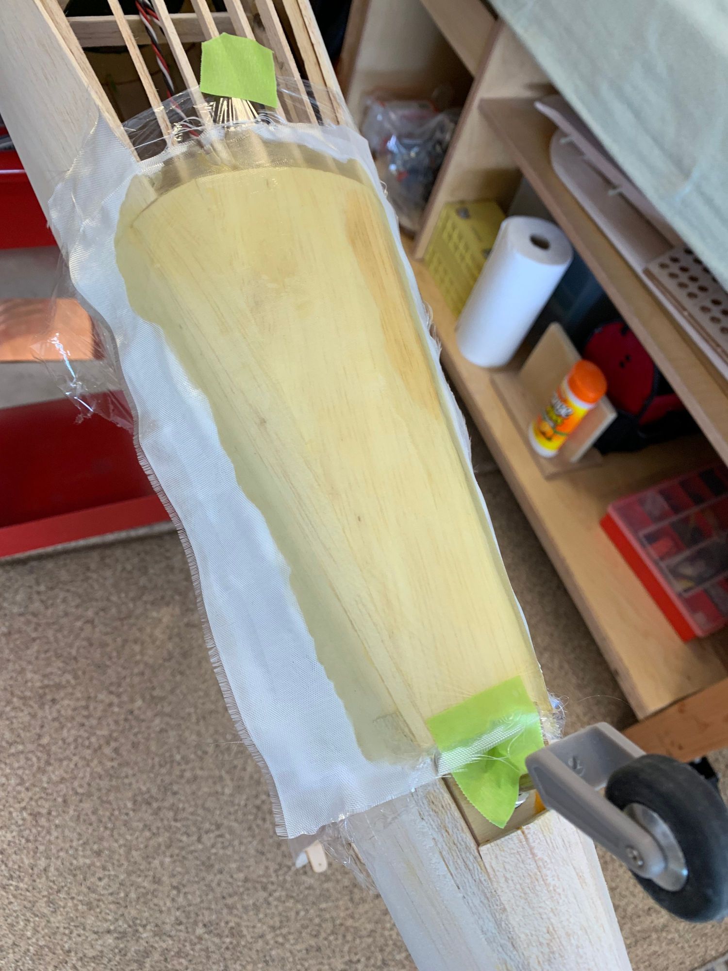

BatteryBob September 15, 2019
I needed to add access hatches for the elevator servo connections and the rudder/tail wheel controls. I used Zpoxy and several layers of FG over Saran Wrap. The rudder/tail wheel area is tight and right under where the elevator/fuse fillet goes.
