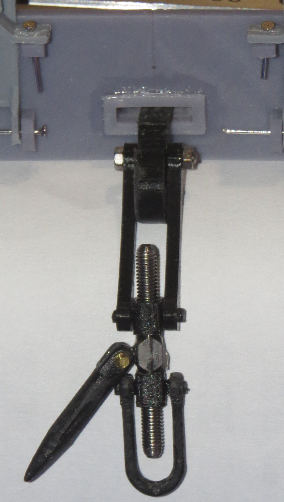

Shark27 September 18, 2021
Coupler in tightened position, some length adjustment to the shackle end piece may be necessary as it would not be able to tighten down this far with a coupler hook in place. It may not have to tighten anywhere near this amount as the distance will determined by the how soon the buffers contact the other rail car's buffers. Experimentation will tell.
